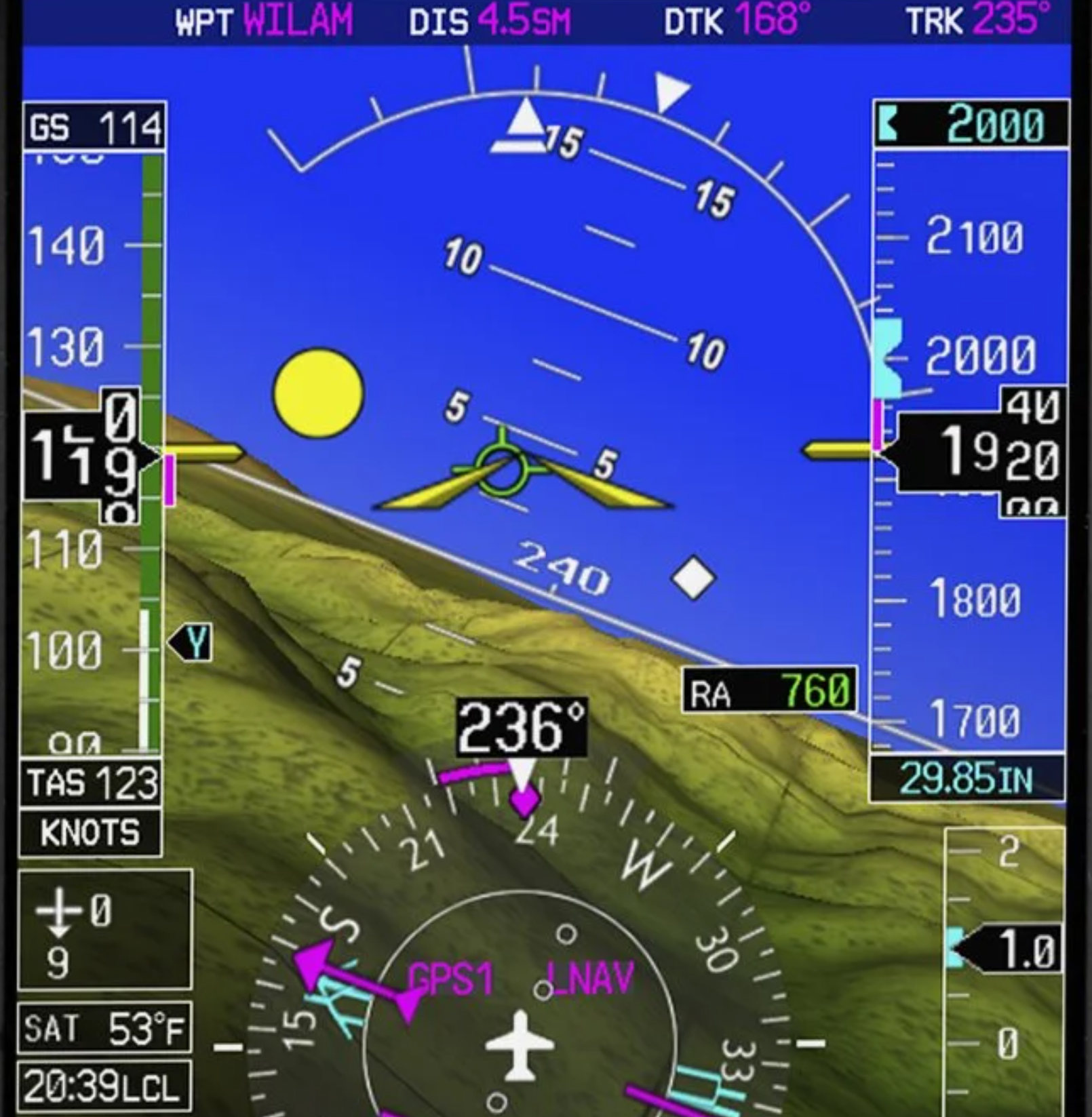

Postby Gabriel » Thu Nov 14, 2024 7:05 pm
Here in the AD you can see that a little left rudder is needed (the bar under the top triangle is displaced a little bit to the left, stomp on the bar).
And in the HSI you can see the heading trend, which is indicating that, at the present rate you will be almost 20 degrees to the left in I don't know how many seconds. If it's 6 seconds, 18 degrees (still almost 20) would be 180 degrees per minute or a standard 2-minutes turn.
Neither of these indications strikes me as intuitive, but I have never used this type of modern instrument. When my vacuum-powered artificial horizon was no out of service, I was happy.

Thanks for the screen grab. Cool that you can flip a “switch” to get different depictions…as long as the computer isn’t “thinking too much” so the pilots ask, “What’s it doing now?”
